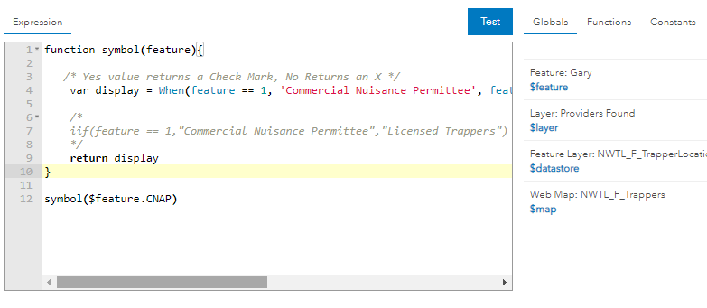

Is it possible to add an URL image to an attribute Expression?
I want the text to be follow by a specific image based on the field value. I can get the text to change with no issues but want to add a specific image
function symbol(feature){
   image1 = "https://img.icons8.com/color/search/96 "
   image2 = "https://img.icons8.com/color/search/96 "
   var display = When(feature == 1, 'Permittee' + image1, feature == 0, 'Trap' + image2, 'n/a');
   return display
symbol($feature.LOK)‍‍‍‍‍‍‍‍‍‍‍‍‍‍‍‍‍‍‍‍‍‍‍‍‍‍‍

I was able to do it this way....I assigned an IMAGE to an expression and then used that expression in the popup
EXPRESSION ( IMAGE{expression/expr4})
function GetImageOnClass(feature) {
     var lst = ['95', '96'];
     var base_url = 'https://img.icons8.com/color/search/';
     var url = '';
     if (feature == 1) {
          url = base_url + lst[0];
     } else if (feature == 0) {
          url = base_url + lst[1];
     } else {
          url = 'https://www.yahoo.com';
    return url;
var cnapper = $feature.FieldName
return GetImageOnClass(cnapper);‍‍‍‍‍‍‍‍‍‍‍‍‍‍‍‍‍
HTML on the POPUP
<div style="width: 100%; height:30px; vertical-align:middle;   ">
         <div style="
             width: 5%;
             vertical-align: middle;
             float: left;">
             <img alt="alternative text" src="{expression/expr4}" style="
                 width:25px;
                 height:25px;" />
      </div>
 </div>
jaykapalczynski
Honored Contributor
I guess the question is can I format an image in the Attribute Expression and then apply this Attribute Expression in the Popup? I can do it with Text but want an image....
Then based on the value of the field I can change the image being represented
In the example below I am hardcoding an image into the popup....but I want to be able to change this image based on a field in the actual data...
So the image would have to be formatted or constructed in the Attribute Expression
