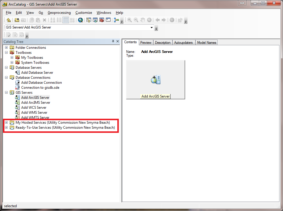

One way to quickly check if your account has access to a server is to open ArcCatalog, login to ArcOnline and then you will see what "My Hosted Services" are listed for your company.
The area in red is where you will see your Hosted Services.
