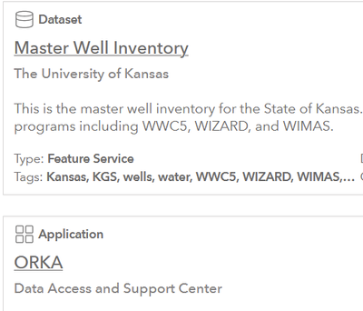

The Admin Tools will help update tags, description, attribution, but it doesn't it other metadata items like any of the item contact fields.  In this shot, I have two items. Both are shared to the Hub by the same account. The top one pulls the name of the organization from which the item was published. The second item was a manual change in the Metadata Editor to something more specific. This is what we'd like to do as a blanket change. The manual change involves too many button clicks and waiting for things to load. We're at 120 or so items, but other org's have hundreds, so I'm curious to know if there's a better way to change a metadata attribute that isn't a tag, description, title, etc.
