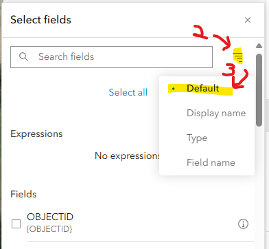

Hi @JuliaFigueroa,
You now have the ability to sort the field order in the Select Fields link of the pop-up's Field List configuration.
The "Default" option sorts the fields to the order they appear in the Feature Service.

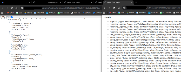

All of these workarounds appear to be band-aids for the bigger issue of the underlying web map JSON "fieldInfos" property ordering the fields alphabetically instead of respecting the source service's field order. While these workarounds are great for authoring pop-ups, I am struggling to generate exports from widgets in Experience Builder that point to web map layers as their sources that respect the service's field* order.
Web map JSON "fieldInfos" (alphabetical) vs service field list (as published):
I will submit a support ticket and check out the Experience Builder forums as I know this is veering off-topic for this post, but just wanted to check if anyone had a similar experience and a workaround for that use case, as it is closely connected to this issue. Specifically, I am trying to generate Query results that use the web map pop-up showing a subset of fields for in-app display, but still respect the service order of fields when exporting all fields to a CSV. Thanks!

To sort the attribute order in a pop-up, it's very simple;
In the pop-up settings, just toggle select/deselect/select and all attributes are added back in the order of the attributes published.

@LowerFraserFisheriesAllianceLF  This would be in the ArcGIS Online Web Map. Deselecting, and selecting all should reorder them, and then you can just drop off any unnecessary/bloat fields (as mentioned above by @JonathanMcD). You can also deselect and then click each check box next to the field to build the fields in a specific order if you'd like.
