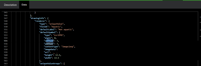

It would be extremely useful to be able to easily offset points in map viewer. We often work with related spatial data with the exact same geometry. A work around is to use AGOL assistant to manually change the X and Y offset values in each symbology class, but we cannot find a way to do this in map viewer.  We would also like to be able to offset by an attribute like you can with transparency and rotation.
