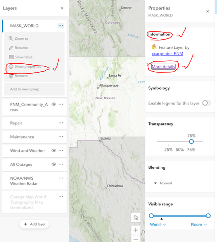

Select "Show Properties" from a layer's menu, then look over the right for the Properties pane. Click on "Information" in that pane to expand it, and then you will see a "more details" link that will take you to the layer's "Item Details" view.

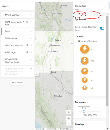

I followed your suggestion and the "Information" item was not displayed in my properties screen as seen in this screen shot:
I then went to another layer that I had never tried before and followed the same routine. Guess what...boom...it was there as seen in this screen shot:
So yes the option to see the details is there and thanks for showing me what I could not see! Not obvious... I believe in my case though the reason I could not see it was due to an incompatibility between the new and the old. The layer that did NOT provide me the "Details" was originally placed in a standard webmap and then opened in Beta Viewer. The layer that DID provide me details was added while in the Beta Viewer.

@ccarpenter_pnm can confirm that I see the same unexpected behaviour with the Information section missing as well when mixing the regular and beta Map Viewer.
