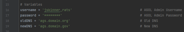

The Variables section of the script is the only portion that will need to be updated:
VariableDescription
usernameAGOL Administrator Username
passwordAGOL Administrator Password
oldDNSThe portion of the URL to replace
newDNSWhat to replace the URL with

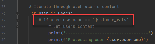

Additional Notes:  I recommend testing on an in individual user first.  To do so, uncomment line 77 and specify the AGOL username.
