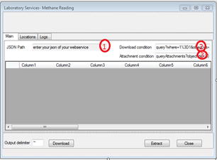

How to use the executable
  1. Fill the main tab
Screenshot index
Value
Description
(1)
Enter your feature service url
http://somesampleserver.com/FeatureservicePath/ArcGIS/rest/services/LabOfflineGdbT3/FeatureServer/0/
JSON location
(2)
Hardcoded but need to change if esri changes it
search url for the webservice
(3)
download JSON url
