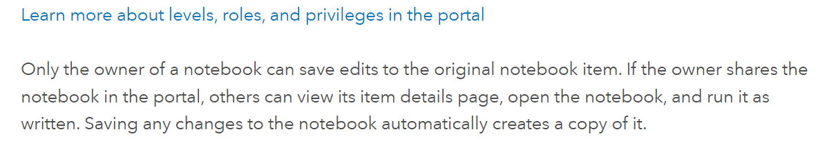

There is a paragraph in the Docs mentioning that only the Owner can save edits, but the results above are the Owner saving his own Notebook.  Docs..https://enterprise.arcgis.com/en/notebook/latest/administer/windows/control-notebook-user-privileges...

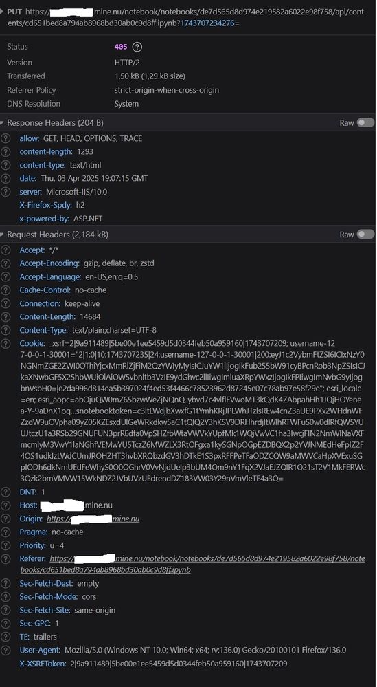

Sorry to wake this thread up, but would you mind sharing how you solved it? I'm having the same issues with a newly setup Notebook Server 11.4
CodyPatterson
MVP Regular Contributor
Hey @AndreasStula
No worries at all, the save as button was resolved for me probably slightly differently than the original poster, I use a reverse proxy in our organization which caused a multitude more issues than would normally be there. In my case, I needed to proxy out our websockets using the wss protocol and this resolved it for me. Do you happen to have any screenshots of the console to see if there are any errors?
Cody
AndreasStula
It's really strange, there is nothing special about my setup. (It's just a test-env) Three machines, one running a Base deployment, one Knowledge Server, one Notebook Server. Base deployment exposed to internet, 4 webadaptors. I really don't understand why it should be throwing a 405 when pushing the save button. Just like the other examples, pushing Save As does also push an error, but atleast the notebook saves. Everything else works just fine (working with Knowledge graph, publishing services, editing)
