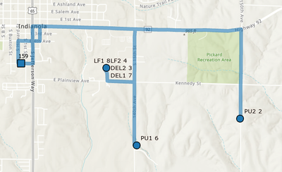

Hi @GarrettMelvin  Something along the  here is what i had in mind. Each of the points below is labeled with the order name and the solved sequence. The Depot is labeled with the sequences of the depot visits (1, 5, and 9)
The route has a capacity of 1. It begins at the depot empty. it travels to "PU2" and picks up an order with pickup quantity = 1. PU2 is paired with DEL2 at the landfill, it visits there next with sequence 3. After if services the delivery at the landfill, it picks up another order (assigned by the VRP) at the landfill with pick up quantity 1 - which fills the vehicle again. Next it visits the Depot to renew as sequence 5. It then travels to PU1 to fill the capacity again. PU1 is paired with DEL1 at the landfill and that's sequence 7. Another landfill order with pick up quantity 1 is serviced as sequence 8 and that forces the vehicle back to the depot to renew again as sequence 9.
