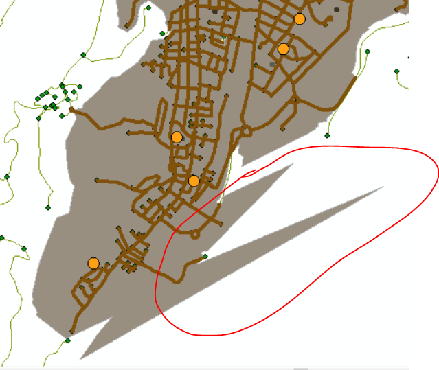

I am trying to use network analysis - service area - to create a polygon based on distance, for example 1000 meters.
In my case, dot = schools. So I want to see an area covered by 1000 meters.
There's one thing I can't understand... Why does it generate some weird clippings? as in the photo
Thank you so much!

Spikes like that are a common artifact of the polygon generation algorithm in ArcMap.  We have implemented a new and improved polygon generation algorithm that makes the Service Area polygons look more bubbly or cloudy and less spikey.  You can access the new algorithm in one of two ways:
1) In ArcMap, open the properties of your network dataset. On the Optimizations tab, turn on the box for the Service Area Index.  You might need to re-build your network dataset after this, but I can't remember.  Future Service Areas using this network should use the newer algorithm.
2) Use ArcGIS Pro instead of ArcMap.  ArcGIS Pro Service Areas always use the new algorithm.

Hmm, that still does not look like polygons produced by the newer algorithm.  Is your polygon detail level is set to Detailed? Or do you have hierarchy turned on?  Either of those things will prevent the use of the newer algorithm in ArcMap.
Do you have a polygon trim distance set?  If not, you should set one, and that may help reduce spikes.

I can see in the video above that you are not using trim and that you have selected Detailed polygons.  The Detailed polygons in ArcMap will never use the new Service Area algorithm.  If you want to use detailed polygons and see the nice new polygons, you need to use ArcGIS Pro.
If you want to get rid of spikes using your existing Service Area layer in ArcMap, I suggest you set a polygon trim of something like 50-100 meters.
thainamota
Hi Melinda, I followed all your instructions (as I show in this new video) The result generated a unique polygon when I used trim + merge polygon, without stranges spikes. I also used trim+no merge, which generated some internal clippings.
In neither of them the result is great but I understood the differences!
