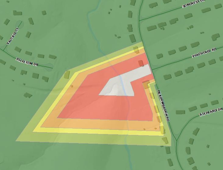

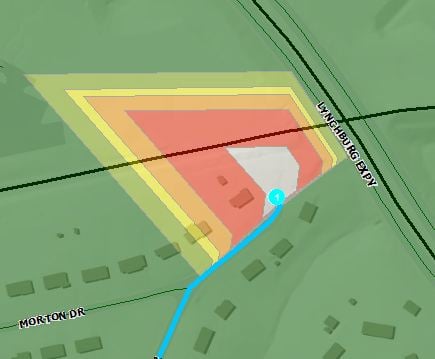

Hello,
I am attempting to perform a Service Area analysis and am getting unexpected results. I am running the analysis using the detailed polygon generation. My issue is that there are a significant number of holes being generated in the service area results. To test these anomolies, I've run a simple routing problem to verify whether or not these "holes" are routable. In each instance, the routing problem is solved without issue. In the screenshot below, you can see the hole in the service area analysis. The turquoise line is the result of a routing problem. It solved correctly and the cumulative time indicates the entire hole in the service are polygon should be green (<5min drive time.)
I'm sure there is a setting that I am missing, but I've tried everything I can think of. I'd prefer to not user the generalized polygon generation setting, as the results negated a few pockets of "hard to reach" streets.
Any thoughts would be greatly appreciated.
Shaun

I have run into weirdness like this in the past when deriving Service Areas with Network Analyst.  Sometimes it seems to have a mind of its own and produces strange results.
Just to be on the safe side, though, if you haven't done it already I would run topology on your data to ensure it all is connected correctly.  Sometimes it seems like having just one disconnect in an otherwise connected dataset causes the strange results.
For example, a break in connectivity in your lower image at or near the junction of Peachtree and Meadowbrook might yield the result you have.  Keep in mind that often the lines/edges will look connected when inspected visually, but topologically be off by a very small amount, rendering them unconnected from Network Analysts' perspective.

When using detailed polygons in Service Area, holes are normal and expected.  Detailed polygons provide the most accurate representation of the area that can be reached within your time or distance limit.  It is quite possible that there might be pockets of unreachable areas completely surrounded by reachable areas.  For instance, it could take quite a bit of time for your fire truck to wind its way through a bunch of curvy subdivision roads to the end of a cul-de-sac, so the cul-de-sac might not be reachable even if the surrounding roads are, leaving a hole in the middle.  You might also have a stretch of road with a restriction on it, and Service Area polygons will not be drawn around it if the road is restricted in the analysis.  Finally, there might simply be a large area with no roads, such as a river or lake or forest.
That said, the holes you're getting might be a symptom of a problem with your network dataset (and the screenshots make me think this is indeed the case).  In addition to the topology issues mentioned above, there are a few reasons why some
- Your road has a one-way problem where both directions of travel are restricted (a 0-way road).
- The impedance is calculated incorrectly for the road, giving it an extremely high value that makes it effectively unreachable.
- Your road has a restriction placed on it incorrectly.  For instance, there might be a height restriction with an unreasonable height limit.
- The roads intersecting this one connect to it at vertices, but you're using an End Point connectivity model, so the roads don't actually connect.
Some debugging tips:
- Run the service area again with all the same settings, but check on line generation.  Are the Service Area lines covering the roads where the polygon holes are?  If not, then that looks like a symptom of a network connectivity problem.
- Create a Route analysis layer and drop two points on either side of that one troublesome road segment.  Can you calculate a Route and force it to cross that road segment, or does it loop around the block instead in order to get to the other side?
- Use the Network Identify tool (on the Network Analyst toolbar) to click on the problem road.  A pop-up window will appear, and it will show you a list of all the junctions and edges that are connected to that road.  You can click on the items in this list, and it will highlight them on the map.  If the road isn't connected to the surrounding roads the way you expected, then you have a network connectivity problem that needs to be solved.
