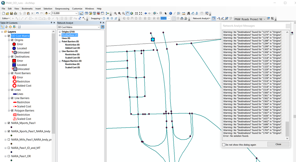

I dont think so.  I checked and it all looks fine.  Below is a screenshot of the network edges with the Restriction symbology (one way and two-way) turned on.
DanPatterson_Retired
MVP Emeritus
Looks can be deceiving.  When confronted with problem like that, I just try to go around a corner in both directions or straight ahead from the offending point.  Sometimes zooming helps,  unless there is no intersection where two lines meet (ergo, an overpass or underpass) and the network isn't configured to handle all realities in the field.

Based on the image you provided, I'll throw out a guess as to what the issue is for the one you provided.  It appears the Destination that is highlighted is on a divided highway, with one-way traffic flow.  If the data is for a country with left-hand drive (like the United States), the segment it is on is going "South".  At least given the image shown, there is no way to reach that destination given the only segment visible is one-way away from the destination - i.e. the destination is "North" but the only segment near it goes "South".
Also, the traffic lane going the other way also appears to be reversed from the expected travel direction, at least the arrows on your data make it seem so that way on the last segment approaching the Destination.  It appears the directionality of that segment is reversed from all the other segments - it is going "South" while all the other ones connected to it are going "North".  So traversing the network to the point the other way (via the "Northbound" lane will not be workable either (and this will defeat a search or snap distance to some extent).
And if your data is for a place like England, my apologies for the fact that the Brits do everything backwards...

Visual of some potential issues specific to the image you posted:

A HUGE THANK YOU to both Chris Donohue, GISP and Dan Patterson for answering my question.  Chris, you were right in that both of my points were on the wrong side of the one way (love making these kinds of mistakes...), and additionally, some of the one-way directionalities in the road network attribute table were going the wrong direction (FT instead of TF) so the routing was broken, even when they were placed on the right side of the one way.  Your recommendation to run a service area and turn on the lines was spot on.  THANKS!!!!
