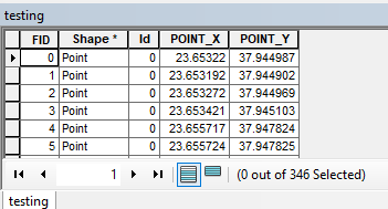

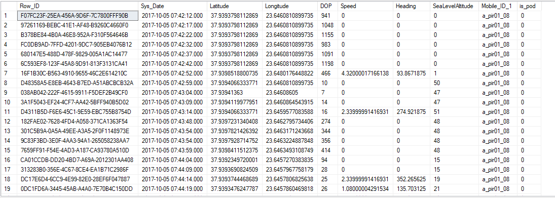

The problem that i m facing has to do with the fact that the created shapefile's attribute table is missing crucial information.The source table has the following fields
the shapefile's attribute table has the following fields
Is there any way or python method to auto add more fields (i.e Speed) in the attribute table? Any help would be appreciated.

you only create the x, y coordinates for the output.  do you have a common field that you can use in a join?
sotokan80_
The common fields are those with the coordinates. But I was trying to avoid joining the tables because i get too many unused fields or empty fields. Is there any other way to add fields in the attribute table?

JakeSkinner
Esri Esteemed Contributor
You can simplify this by running the Make XY Event Layer function in your script.  This will retain all of your attributes.  You can then use the CopyFeatures function to copy this to a shapefile.
sotokan80_
Can you give me a small tip on how to use the make X Y event function.Do i have to create a temporary table because the function's syntax specifies that there is an input table
JakeSkinner
You would reference your database table through a Database Connection.  In the below example I'm connecting to a SQL Server database (not a geodatabase) and referencing a table called XY, creating the event layer, then exporting to a shapefile:
