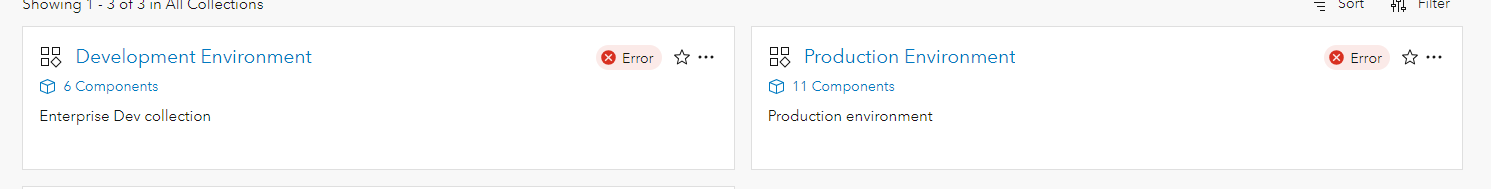

Hi all,
We're new to Monitor, so I'm hoping this is an easy question! We needed to reboot our Monitor server for some Windows updates. Since then, all of our Collections have this little Error flag:

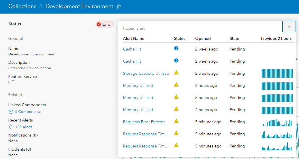

Additionally, when we hover over the Error message, we get a lot of Pending statuses.
All of our Alerts have been marked as resolved, and I don't see anything in the documentation about this? Or maybe I just missed it? Any guidance is appreciated!

Are any of the components in the collection also in the "Error" state? Collection status is driven off of the most critical status of the components that participate in it.
