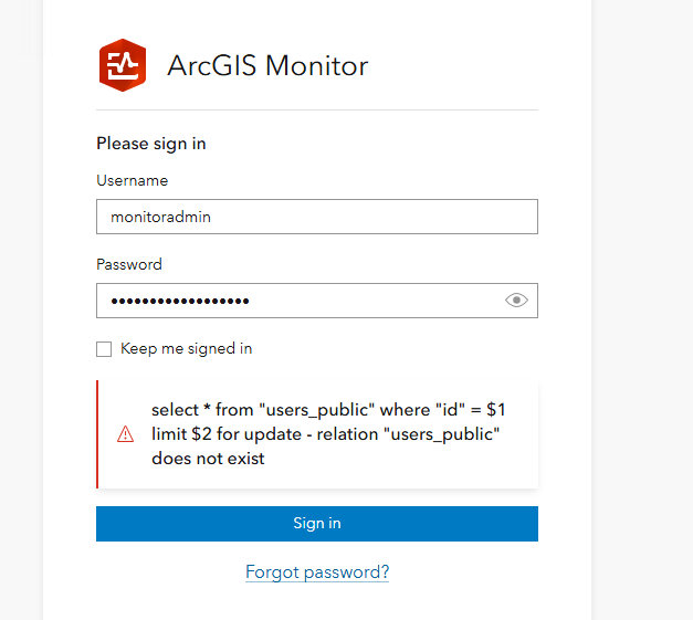

I am trying to upgrade Monitor from 2023.3.3 to 2025.1 and am becoming deeply frustrated with the process. I have been following this guide to the letter...it does not seem like it should be that difficult. I confirmed that the underlying pgsql database is a supported version and created a backup. The installer for Monitor Server 2025.1 works fine and eats my authorization file, but then I encounter this error when trying to log in:
Even better, when I go and look at the installation directory on my D drive, it looks like basically nothing is there. Folders are extremely skimpy and don't have contents. I assume that is what the error is about..I think the folder, contents, or whatever from 2023.3.3 was not migrated to 2025.1. That's just a guess
I think something is deeply wrong with the installation process, even though the upgrade is said to complete 'successfully'. I attached what I think is an error log that looks fairly horrendous when you start parsing through it. Please help, I have no idea what is going wrong during the installation; this is causing our team a lot of headache.
So, after thinking about this more, I'm circling around the underlying pgsql database as the source of the problem. I took a look at the script that I used to originally create my agm database back when I deployed Monitor 2023; the script contains a line:
ALTER DATABASE agm SET search_path TO "$user", public;
I'm just guessing, but that looks somewhat related to the error message that I'm seeing. In the documentation for deploying Monitor 2024 or 2025, that piece of code/query is not there anymore. Is that a database parameter that I need to remove before upgrading? It seems like it might not be used/necessary anymore?
Hi @GrantSmith122 ,
Please contact Esri Tech Support and open a case so they can help you investigate your upgrade issue. It's difficult to assist without getting more detailed information about exactly what you did to perform the upgrade process.
Nope this is not part of the upgrade process.
