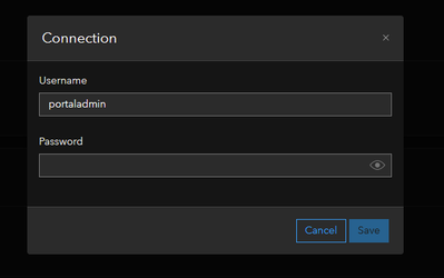

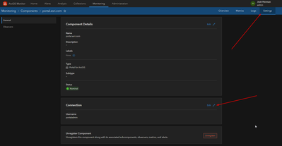

One possibility is that there are incorrect credentials stored for the Portal for ArcGIS component. This would cause the observers to not be able to connect to the component which would result in the connectivity metric reporting 0%. You can update the credentials for the component by going to the Settings page and clicking Edit under Connection:
If you are still seeing this behavior after updating the component credentials, then there must be some other automated process trying to log in with invalid credentials, like FME workbench. Hope this helps, let me know if you have any other questions.
