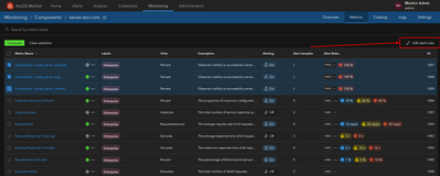

You can edit metrics individually by navigating to the component overview page and clicking "Edit alert rules" for the metric you want to edit:

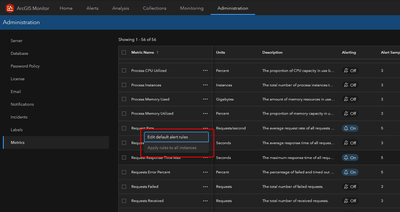

If you would like to set default alert threshold rules for metrics, you can do so in Administration > Metrics, which can then be applied to existing metrics in bulk using the "Apply rules to all instances" option:
