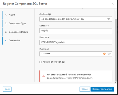

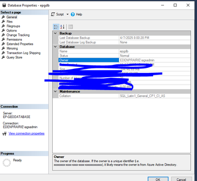

@DerekLaw I'm also a bit stumped on registering a SQL server with my 2023 Monitor. Here I have my database shown in SSMS with my deployment wide ArcGIS Admin account logged in:
But I can't seem to get Monitor to recognize the user
I've tried without the domain in front of the user name, I've tried a couple other user names but nothing seems to work. Am I missing something about the login user?

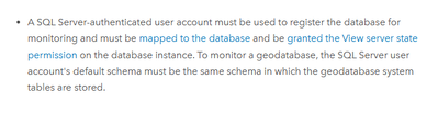

had been sure, but I reviewed the prerequisites and I had been tripped up with this one:
I was attempting to use our deployment-wide admin account, which was a windows user that hadn't been given an explicit SQL login. So I got it working now, thank you!

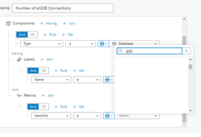

edit: @DerekLaw so I should say, I got the database connected and I'm trying to set up the monitoring charts in this blog, but the gdb metrics(gdb_version, gdb_connections, etc)  are not coming through as options when I try to set up the expressions:

> ... the gdb metrics (gdb_version, gdb_connections, etc)  are not coming through as options when I try to set up the expressions
I don't mean to state the obvious, but are you sure you registered an enterprise geodatabase (that is implemented on SQL Server) and not just a "regular" SQL Server database?
The gdb_ metrics are only available for enterprise geodatabase components and not "regular" databases.

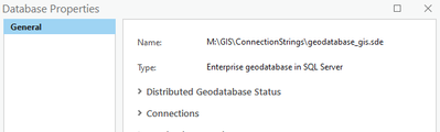

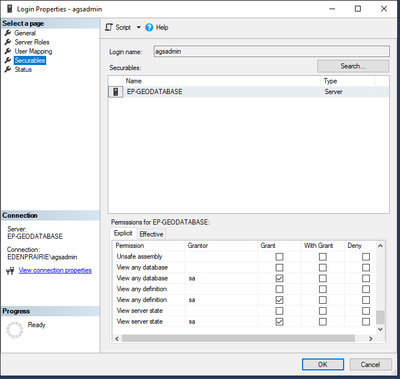

 I believe yes to both? If I check out the properties in Pro, it says it's an enterprise database:
and the user has all of the view permissions checked on (although not being a SQL pro, I could definitely be missing something here)

Does the SQL Server account that you're connecting to the enterprise geodatabase with, have the following:
"To monitor a geodatabase, the SQL Server user account's default schema must be the same schema in which the geodatabase system tables are stored."
This is in the help topic I referenced in my previous post.
