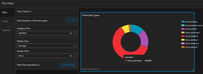

Below are the screenshots for the queries that we have configured for total number of contents created last week but still we can see in the graph total number of contents created till date.
1: Configured Query
2. Output Pie Chart:
Here we can see the number of layers till date and value of the number layer shows in decimal format.
Is this a defect or enhancement or if I am missing something in the configured query.

In the output pie chart example, it looks like the query result is correct - but the pie chart's descriptive text (under the General section) says "Within the last 30 mins”, this should be changed to say "Within the last 7 days" - this is a string field and is not populated by the query.

We wanted to say that still, the pie chart is not giving us the data for the last seven days. It is still showing us the data for the total no. of items created till date.

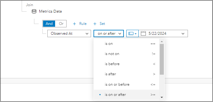

You'll need to modify the data expression in your first screenshot, specifically the "Observed At" parameter,
Query: "Observed At" "is on or after" "select the date"
For example, if you want to show the items in the last week (from today 5/29/2024):
Next, when configuring the pie chart element, under Data > Statistic Type - select Count.
