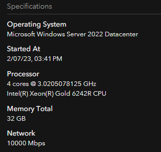

We're not a PostgreSQL shop, so I had to deploy an instance. To save on machines, I opted to put it on the same box as monitor. Been working pretty good and memory utilization has been around <12% with CPU bouncing up to 50% every so often. Its a leaner and meaner than the old version. 🙂

We're not a postgres shop either.  We are a Windows shop.  Typically we carve out 8 core 32 gig VMs on our VM host to run all Enterprise components.   As a rule of thumb we always go with 4 gig per cpu - maybe I'll do 4 and 16 for Monitor Server since it is lighter, as you say.
But - Are you saying you needed to install a postgres instance on the server, then the Monitor server?  Or does the Monitor server install add a postgres instance as part of it's install?

8 core 32GB to 64GB (per component) is about my average as well. I have some things that are smaller, but that would be the web adaptors or some low use component.
WRT how I configured things, I configured PostgreSQL to be on the same server as Monitor. This eliminated me needing to request another box, and since we are not really setup to support it (from an org enterprise perspective), it kept it out of prying eyes/hands/fingers.
No, PostgreSQL is not included in the installation. You have to do that all on your own. You can set it up on another server entirely, but it worked just fine for me on one box. Resource wise, its been solid to date with plenty of room to spare. I think I would have preferred a black box solution like using a datastore server perhaps, but that's just me trying to be lazy.
