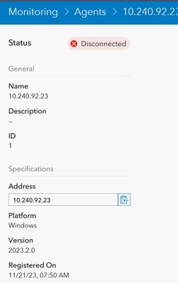

Hi @DerekLaw I successfully upgraded the AM Server and Agent but received an error when running this command:
DerekLaw
Esri Esteemed Contributor
Hi @KikSiops,
It looks like you need to run the command from the Monitor Agent installation location.
Hope this helps,
