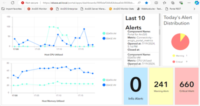

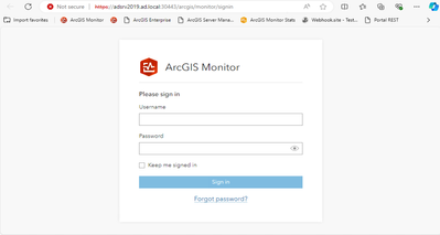

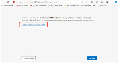

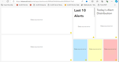

I believe this has to do with ArcGIS Monitor's built-in self-signed certificate.
When working with the built-in self-signed certificate, if a users browser security warning to port 30443 has not been bypassed, then the collection's feature service will be blocked in the portal and dashboard.
As seen below:
A fix to prevent named users who wish to view these metrics in a portal dashboard from periodically requiring to suppress warnings from self-signed certificates, would be to either use a CA-signed certificate or domain certificate. Optionally following this Blog post on how to Connect to ArcGIS Monitor 2023 through IIS should also work.
