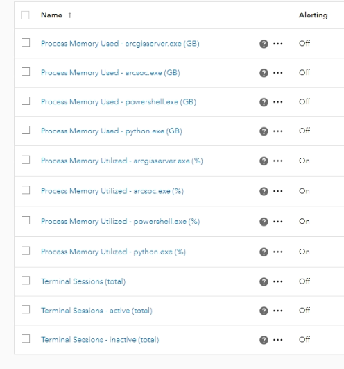

Hi there,
As well as ArcGIS Enterprise we have a standalone GIS server site. I have added the 2 hosts to ArcGIS Monitor (2023.2) but do not have a full suite of metrics. I have the base mectrics but do not have the arcsoc memory and cpu usage for each service (like I do in the enterprise GIS servers).
I just have the base metrics like this:

Hi @FraserHand ,
Is memory usage maxed out when that observer runs? I see Not enough memory resources are available to complete this operation in the error message you posted.
FraserHand
Hi Josh,
We were having memory issues earlier in the week which we have cleared - have rerun the obsever now returns this:
["New-CimSession : The client cannot connect to the destination specified in the request. Verify that the service on the"]
still no individual service metircs.
