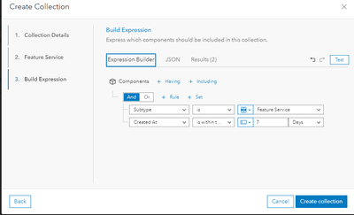

What about using a Collection.  And then set it up like this. Would that work?  I am not 100% sure what the Created At metric is.

To be specific, it is a time when this service component was registered with ArcGIS Monitor.   In many cases, it could be a good indicator of when service was created, except when you initially register ArcGIS Server.  Also, note, you would not be able to answer this question when service is deleted.  In other words, when a service is deleted in ArcGIS Server, it will be deleted from ArcGIS monitor (no archiving capabilities in monitor)

Greetings @Dan_Brumm ,
Thank you for you reply. I like the thought, but I believe that is when the metric that is being collected was collected. The ArcGIS Monitor Information Model describes created_at as The date and time the entity was created.. Looking at the data, the timestamps in that field for my services are pretty recent, and most of my services have been around a while. I hope I'm wrong, cause that would be really easy. Thank you for everything and have a delightful day.

Greetings @AndrewSakowicz,
Thank you for your response. That is interesting. If I am following along correctly, is it safe to say that what @Dan_Brumm proposed would work to tell me when the service was published, but isn't working due to that bug? Thank you for everything and have a delightful day.

Greetings @AndrewSakowicz ,
Thank you for the clarification. that makes sense. I will give this a shot when the bug is resolved. Thank you for everything, and have a delightful day.
