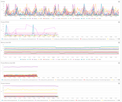

We keep seeing partial reports on the Home & Analysis tabs, these partial reports persist even when we change the windows of time.   Is this a bug or just something happening in our environment?
AndrewSakowicz
@SteveMcCarthy , two asks: 1. Can you share the expression for the process cpu, mem, instance? Is the expression the same for all processes?  2. pick one process metric from analysis and go to the individual metric.  Is the chart "partial" or not?. In any case, I think the main issue is there are too many series and the charting framework limits the display.  We can help you modify the expression to return fewer points.

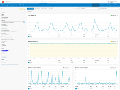

The data metrics when the viewing a component under the Monitoring tab looks normal.

@SteveMcCarthy it looks like the "partial" charts are for process metrics.   It is expected behavior when processes are not present anymore, e.g. arcgis server restarted, service deleted, etc.  You would see the same if go to this process metric using component UI (not analysis).  What you showed above is a host metric, not process.  Also, it looks like this analysis shows up to 97 processes.  Depending on the resolution, the charting might limit it.  In the next releases we'll introduce TOP features.  In the meantime, you may need to modify the expression to reduce the number of series.  I hope it helps.

This our Production environment, processes are starting and stopping all the time.  However, we don't stop these process or services all at once in our Production environment.  Also if you notice the Process CPU %, Process Mem Usage (GB) and Process Instance are all stopping reporting at different time.

I did find this known issue:  Charts series are limited to 10,000 points using alphabetical order.
For example, you want to show all processes for the last 2 hours of data with 1 min resolution.  The chart will show 10000/(2*60) =83 series using alphabetical order.
Resolution: If your mission critical process is not showing (you have more than 83 processes), you may modify data expression to limit the series or add processes by name.
You are correct, the main issue is there are too many series, and the charting framework limits the display.  We will try to modify the expression to return fewer points.
