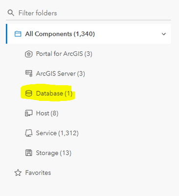

Using ArcGIS Monitor 2023.3.1, we an enterprise GDB registered under Database Components to monitor the EGDB
Now , when I navigated to Component, it shows the Memory Total = 23 GB . Knowing the fact that the
Memory total indicates the total amount of physical memory for the database instance, can someone please let me know if this is the actual size of database in SQL Server or this 23 GB is added up into the ArcGIS Monitor Postgres Database?

Hi @KalkhoranBehrouz,
> .... when I navigated to Component, it shows the Memory Total = 23 GB
The 23 GB memory total metric is the total amount of physical memory for the registered enterprise geodatabase instance.
It does not relate to the the ArcGIS Monitor Database (which stores the collected metrics).
