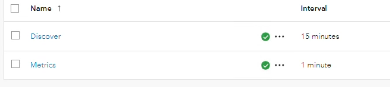

Hi there,
We recently had our ArcGIS Monitor 2023.2 drive run out of space. We've resolved the issue but now have several of our hosts in Error status. The observers appear to be ok (running ok and green) but I've noted that the metrics also seem to be in error. The observers are running ok and nothing in the logs. Is it an issue with the database - the db was running a backup when it ran out of space.

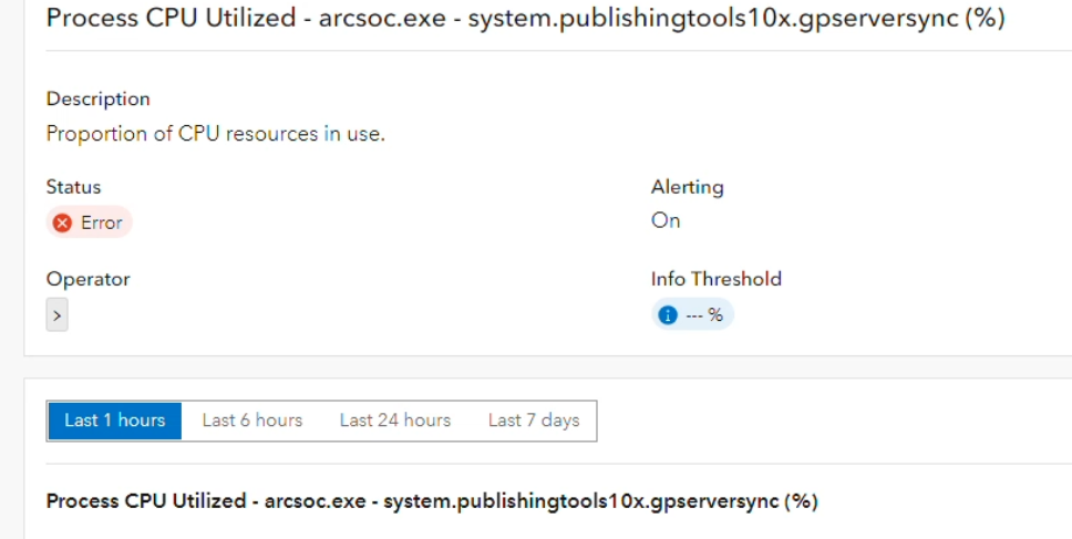

 think I know what's going on - its some of the components are in error like the Process Memory Utilized - arcsoc.exe - system.publishingtools10x.gpserver is in error (11.1 server) so this may need to be refreshed.
GeoJosh
Fraser,
You are correct: the process metrics can sometimes send the component into an "Error" state. The development team is aware of this issue and it is set to be resolved in the 2023.3 release.
Josh
GeoJosh
Fraser,
Josh
