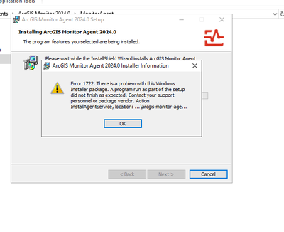

CharlotteNCIT
Thats what I receive when I use the gmsa to install the Monitor Agent @GeoJosh
GeoJosh
@CharlotteNCIT,
We are not able to reproduce this behavior in house. Two action items here:
1. Submit a case with Esri Support to investigate further.
2. Install as another account (domain or local, non-gMSA), then manually switch the service account via Windows Services if the installation is successful. =
Thanks,
Josh
