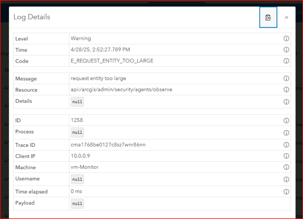

4.  Under Monitor Server logs, the following is shown:
5. Usage reports can be seen via Server admin rest API and displays usage report (required and managed by ArcGIS Monitor to assist with ArcGIS Server metric collection), there are over 14427 service items listed in this report.
