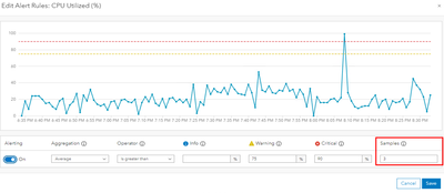

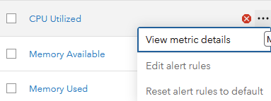

You can indeed change these, going to Monitor > Components > <server> you can see the metrics that are measured. Clicking on CPU Utilized or any other item you'd like, you can adjust the monitoring of that by clicking "Edit alert rules".
You can then set the warning and critical amounts at the bottom:

Just to add to this topic a major improvement that Esri introduced with ArcGIS Monitor 2023 was the Sample interval setting
Samples allow you to filter short-term spikes in metric data values and outlier data. For example, when an alert rule is configured to use the average of three samples and the component's Metrics observer is configured for one-minute intervals, the average of the metric data samples must be outside the configured threshold for three consecutive minutes before an alert is opened. If the average of three consecutive samples doesn't fall outside the configured alert threshold, no alert is opened.
This should limit the amount of false positives you receive with brief CPU spikes and is set to 3 as a default for the CPU Utilization metric. As mentioned by Cody, you could increase the Warning threshold from the default of 75% or even the Samples value, but Critical being at 90% may be a good threshold to keep.
