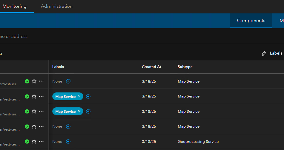

Are Feature Services supposed to show in the Monitoring/Components/Service section? I am seeing everything else in the Subtype column except for my Feature Services

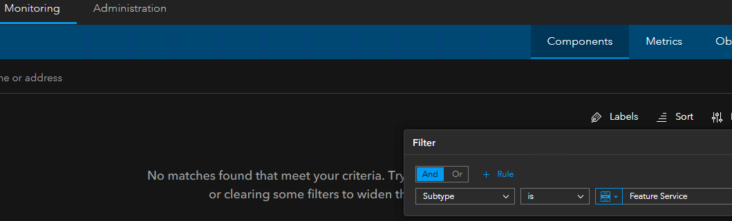

I would imagine they are supposed to show since there is a Feature Service filter.
If I filter the subtype, you can see there are no FS showing
Yes, feature services should appear as components under the Monitoring page. After you register an ArcGIS Server component, its web services should appear under the Services component filter.
In the case of a hosting ArcGIS Server - this was enabled at the ArcGIS Monitor 2023.3 release. Collecting metrics for hosted feature services is only available for hosting servers at ArcGIS Enterprise 11.1 and higher, because the ability to query for these metrics were only enabled at the Enterprise 11.1 release.
