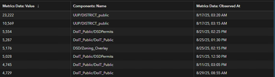

Hi @DavidJantz,
Could you share how creating such a table is possible? - showing the top 10 most requested services
Below is a dataview expression to query for services and the requests received within the last 30 days; it excludes the system services.
EDIT: To clarify, the Attribute table will not show metrics over a time range, only the top 10 most requested services. In this case, in the last 30 days (because of the dataview query). Apologies if there was any confusion in my previous post.
Hope this helps,
DavidJantz
@DerekLaw I think it's important to clarify that this view produces the top (or bottom) requested services within an X-minute period (the observer defaults to 5 minutes). Maybe you can decipher something about usage spikes or repeat services meaning high sustained usage, but it's really not very helpful.
The only current alternative is a bar graph but then you have to visually compare and inspect each item to see the metric value.
Link to idea for anyone reading: Usage Reports and Summary Table Idea
JustinJ_DTS
I agree.  That's what I'm seeing as well.  These table rows show the number of requests per service within each observation interval.  You can sort that and see the busiest 5 minute bursts over the date/time filter set in the top corner of the Analysis window, but the summation is lacking.  I would like to see the services with the most request over the previous 7 days, not the service(s) that had the busiest 5 minutes in that time.
In the example from @DerekLaw , I would like to do a "GROUP BY" on the Components Name column, and a "SUM" on the Metrics Data Value column, then see the top rows in descending order over the date/time interval of the Analysis

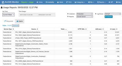

JustinJ_DTS
Here is an example from ArcGIS Monitor 10.8.  It's what I would like to create in 2025.x
