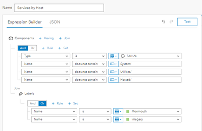

I think you should be able to get this to work with Labels.  For example, I labeled services based on different projects.  I then configured the following expression to see how many services labeled Monmouth and Imagery:

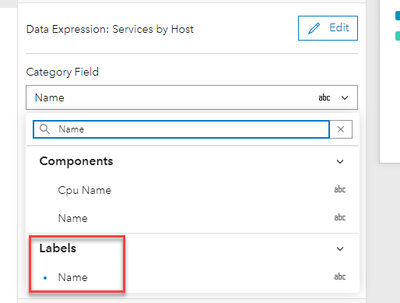

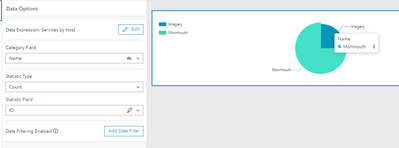

I could then configure the Pie Chart based off of the Name from Labels:
Try the above after labeling all of your services with their appropriate AGS host name.  Note:  you can apply labels to multiple components by selecting them and clicking Apply Labels at the top right.
