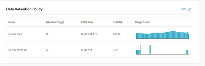

My PostgreSQL directory has grown to 810 GB and I would like to reduce the size of this.  I have adjusted my reporting frequency to help this in the future.

@AndrewSakowicz, I adjusted my retention time from 180 to 60 days and it did change the size of my database last night.  Today I changed the retentions time to 30 days to see if it will reduce the size of my database.  I will let you know if this changes the size.

This was resolved when I upgraded to Monitor 2023.3.1.
