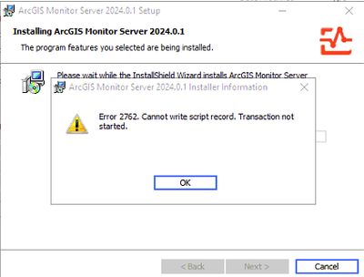

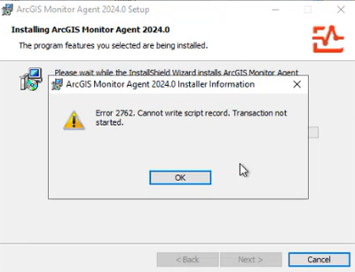

11.2 Enterprise, attempting to install Monitor on Portal server.
When attempting to install Monitor, I am presented with these two errors here, 2024 first:

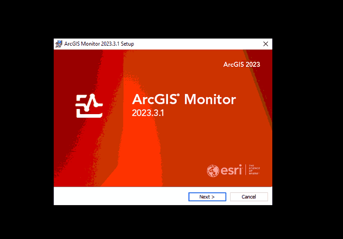

Here we can see 2023.3.1, it loads, and then suddenly reverses and closes without an error:
What should I do from here?

I'm not sure if this is a bug but I also receive that same error when I try to install with a configuration XML file.
Our workaround was quite simple, just manually type in the the service account password and avoid using the configuration file for now.

CodyPatterson
MVP Regular Contributor
Hey @StevenBeothy
Very interesting, thank you for the tip, I'll give it a shot!
Cody
CodyPatterson
Hey @StevenBeothy
Just an update, this worked! After typing it in manually, it does appear that this is some sort of bug.
Thank you for your suggestion!
