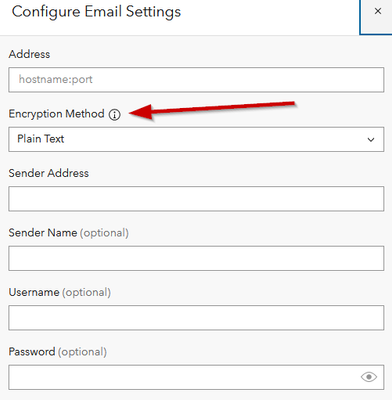

When configuring the SMTP settings for ArcGIS Monitor. Just confirming, you only get the Encryption method drop-down arrow if our SMTP server requires an encrypted connection? Otherwise, there is no longer a drop-down choice.

What version of Monitor are you using? I'm using 2024.1 and I see this here prior to me entering anything:
Are you seeing this by default or is this not appearing for you?
I'm seeing in these release notes at the bottom: https://support.esri.com/en-us/patches-updates/2025/arcgis-monitor-2025-0-release-notes
BUG-000176247: Encryption Method drop-down missing in Configure Email Settings window in ArcGIS Monitor 2024.1.1
Which seems to be addressed in the 2025.0 and 2025.0.1 updates respectively.

Hi Cody,
Yes, the ArcGIS Monitor version is 2024.1.
There is no dropdown. Thanks for sharing the bug and workaround.
