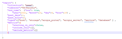

@EdnaKanazawa  Do you have arcgis server service in the collection specified in the SampleConfig.json?  Note, you can remove types as needed, see below

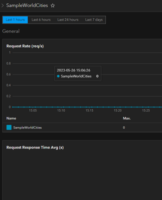

Thanks @EdnaKanazawa Can you verify that you have this metric (request response time) in one of you your services?  Also, can you test removing "service" from types.  If this does not provide clues, l'll contact you directly to troubleshoot this.
