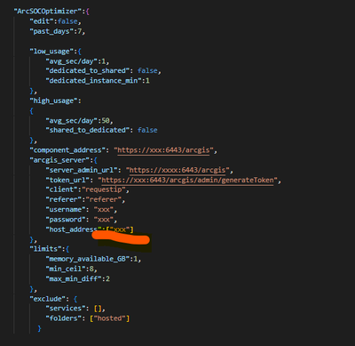

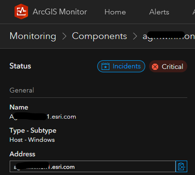

please ensure these host addresses are exactly as registered in monitor.  We can validate it, if can share redacted screenshots of ArcGIS Monitor registered hosts and the below config?

The host_address parameter should be an IP or DNS?
Has to be a Monitor server or ArcGIS Server (hosting server)?
AndrewSakowicz
This parameters needs to have a list of all the arcgis server machines (separated by comma), with the names exactly as registered in ArcGIS Monitor.  Please go to Monitoring>Components and copy it.

1 - I was trying to register Linux Host and I saw in code that has a parameter called windows_strategy, usado na funcao query_by_address como "host_windows_strategy"
2 - The name of Windows host is validate with the name setup at server and return that name. I was using lowercase in sampleConfig.json and the name registered at server is uppercase, so the program didn`t find the host, because in code its look for the exact name in Monitor's resouces.
