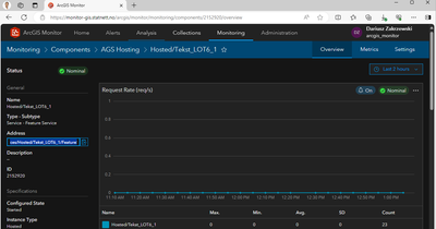

 I am Using version 2023.3. 1 on  AGS 11.1  not able to collect metrics on hosted  features. Hints ?RengifoOrtega_0-1716981065228.png

I'm not sure what you're asking. Based on the screenshot you posted it looks like the hosting server registered with ArcGIS Monitor, it detects a hosted feature service and it is working fine. Metrics are being collected, but there is no activity on the service, which is why the request rate is zero.
Can you please confirm there is activity on the hosted feature service?

In your screenshot, it looks like you're viewing an ArcGIS Server component page.
