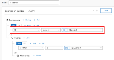

Ryan, can you try combining the "ID equals" rules into one by using the "is any of" operator?

Hi Ryan, can you share screenshots of the data expression and chart configuration settings for the graphs that you're seeing this behavior on?

Sure thing! I pretty much copied it exactly from the sample analysis that was provided with Monitor (which is working fine). The only thing I added was explicitly defining four of my components in the data expression. Otherwise, it should be an exact copy from the sample analysis.

Ah, yes, changing it to that seemed to have fixed it! Now my graph is showing again when selecting a time frame of 2 hours or less. Thank you!
