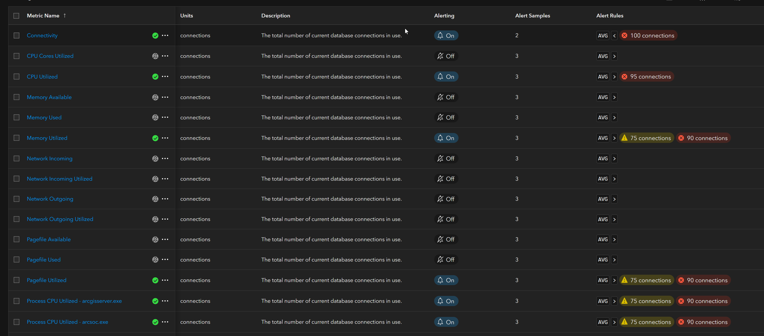

After 2024.1 -> 2025.0 (+ patch), all my hosts show their metrics in terms of "connections"
1396
12
07-31-2025 01:48 PM
Royce_Simpson
The following screenshot shows one of my host components, displaying all metrics with the same description, and all alerts are worded in terms of "connections".  All my host components show these metrics in the same way.  Other components, such as databases, ArcGIS Server, etc, all show the correct metric descriptions.  Is there a way to fix this?

After updating from 2024.1 to 2025.0, I am seeing exactly the same behavior.
Derek - I followed your advice to clear my browser cache & to restart the AM Agent service on one of the hosts, but I'm seeing the same result with this host. Screenshot included here.

Hi @Royce_Simpson ,
I have also upgraded to the latest version and i am seeing exactly the same. The only workaround i found just now is to unregister the agent and register it again which implies that we need to reconfigure all the components again. I have also noticed that cpu utilized metric for one of my machines was reporting wrong cpu utilization values. after unregistring and reregister the agent the metrics got right units and the cpu is getting correct values.
