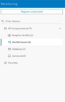

Thanks for the info @TimoT .  I don't think any of the disk drivers were detected during initial registering of the components?  I am not seeing Storage under the Monitoring tab.

Hi @benjamin000,
Storage components are children of host (Windows and Linux) components. After registering the hosts as components, you will see the associated storage components.
