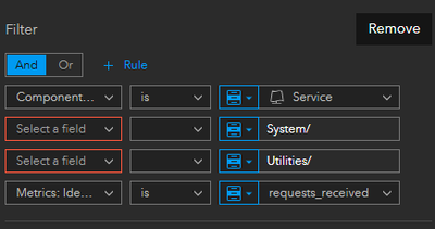

After upgrading to 2024.1, widgets using "contains" or "does not contain" in filters keeps having that rule cleared after clicking "Done". I have tried filtering on different fields and using "is" or "is not" and the common denominator that clears out the rules is using "contains" or "does not contain". Many of my widgets are now broken.

Yeah its really bad too because we lost Instance Saturation % and that's like one of the primary measures I really need, I'm sure others do to.  But just @Joshua-Young says, anytime I try to recreate an Instance Saturation analysis data view and graph, it just clears the filter.
