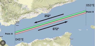

  • Gulf of Aden shipping schema – such as this - if you do not have ArcGIS Maritime Server:
