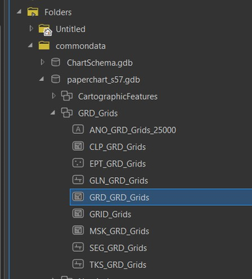

There appears to be some odd cache/refresh issue that I was able to reproduce with your map package. We'll need to look further into the issue, but I believe you can work around it.

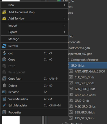

The failure is coming from attempting to open the GRD_GRD_Grids feature class which is generated as part of the MakeGridsAndGraticulesLayer GP tool. After the failure, I refresh the GRD_Grids feature dataset in the target geodatabase and opened the properties on the GRD_GRD_Grids feature class. After this refresh, I ran CAT again and it succeeded.

I try to run MakeGridsandGraticules first, then run the remaining processes, and do not select GPU. So I can create successfull Chart Automation workflow.
