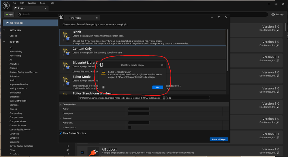

uunkuu
hi?
i've this problem. help me pls.
