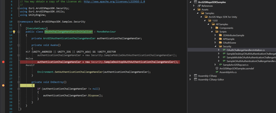

Having set up oAuth2 for play mode, I can see these 2 breakpoints in OAuthChallengeHandlersInitializer.cs being hit... however neither method in SampleDesktopOAuthAuthenticationChallengeHandler.cs are ever hit.
And again, my browser isn't ever opening to ask for credentials, and my private data are not displaying (using oauth2).
