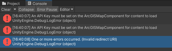

I opened the ComponentGlobalSample scene and configured the OAuth then added a private layer and chose the auth. for all layers:
Now it gives me an error related to the URI:

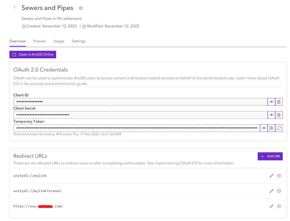

and here are my app. settings in the dev. dashboard:

Ok we shouldn't be erroring like that for the api key in this case but if you add an api key does it work?
MazenTalaat
Adding an API key will always load the layers and ignore the auth.

I also just realized that your redirect URL probably doesn't make sense. On windows the localhost is typically used for the redicect since the local user needs to authenticate. It doesn't make sense to ask a remote server open the auth workflow.
MazenTalaat
You are correct! I added http://localhost:1234/auth as you mentioned here: Automatic authentication in the background and now I can see the auth. page in the browser.
What about android? I tried using unity's deep link: unitydl://mylink?scene1 but it keeps saying URI is invalid.
