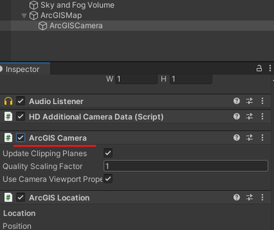

Hi @LukeMcBeath1 , after upgrading a project from v1.5 to v2.1, the ArcGIS Camera component may appear disabled in the editor. You can manually enable it and re-save the scene, and it should then work correctly when entering play mode in v2.1.

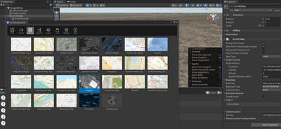

LukeMcBeath1
Map Creator UI

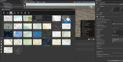

LukeMcBeath1

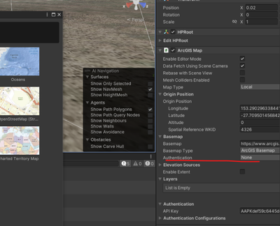

Thanks for your screenshot. We have updated the Authentication workflow.

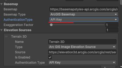

Under your Basemap section in your inspector (using SDK 2.1), you can change the Authentication dropdown option from "None" to "API Key". This should make the basemap display. It seems that you have manually change this dropdown option when you updated to 2.1.
LukeMcBeath1
In the last screenshot I had reverted from 2.1 back to 1.5.
When using the 2.1 library the auth type is set to API Key
The scene viewer shows the basemap, but when I press play it just shows the brown unity ground
